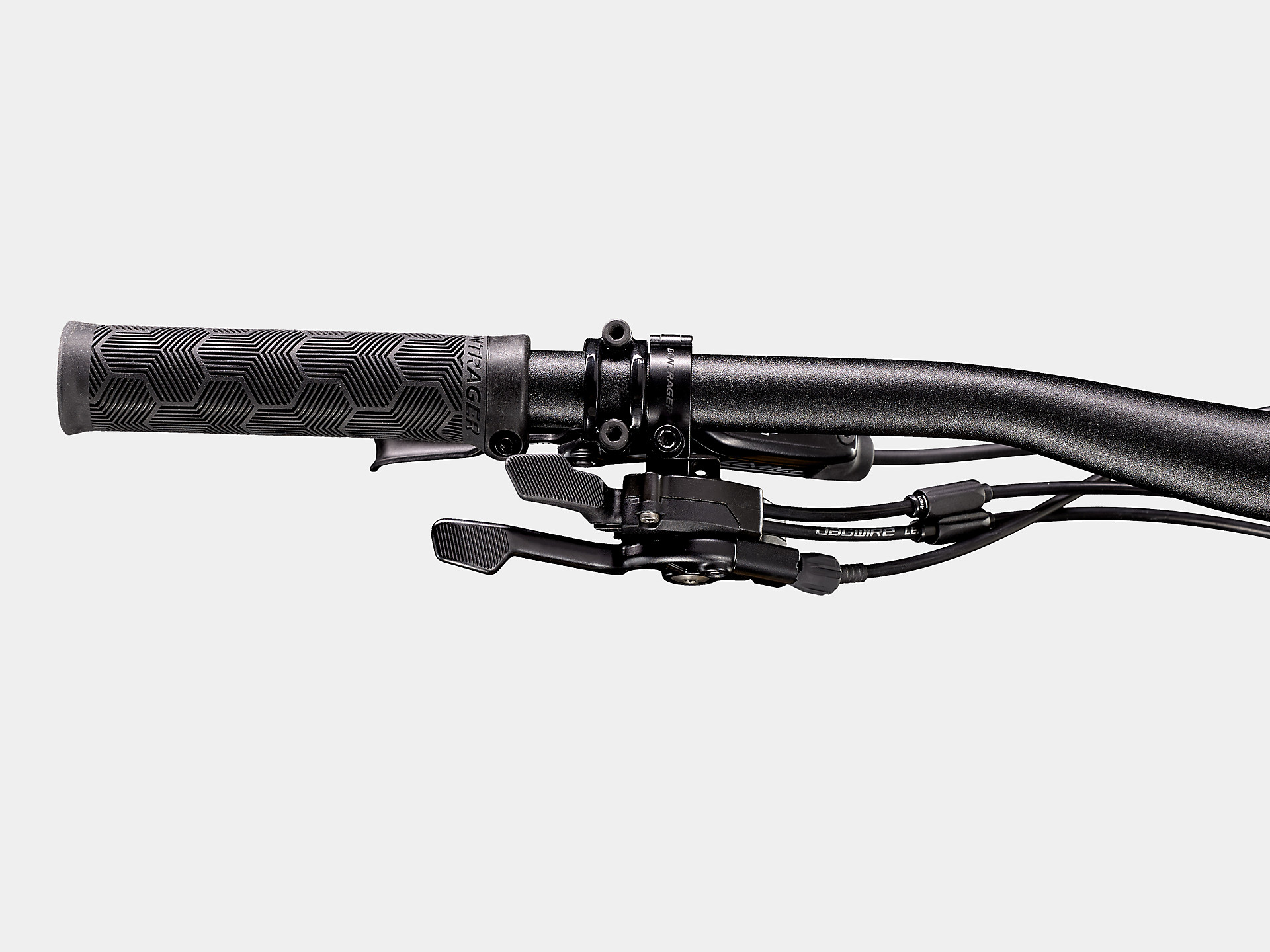

Levers seem really close to me. Maybe good, maybe bad?
And this seems like the dropper version?
