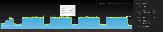

I did Darwin today, 4x10 mins at Threshold. The first two intervals were done in the big ring (52-19), the next two intervals in the small ring (36-19). I changed gears around the 35 minute marker.
Apart from the obviously lower power variance in the small ring, the 3rd and 4th intervals felt considerably easier than the first two, even though I was already fatigued by that point. ā€œRoad feelā€ also changed noticeably. Sometimes it could feel like a wheel slipping on an wheel-on trainer after the switch.
Not sure what to make of this…
Darwin by bergfruehling, on an elite direto. Power source Quarq Dzero crank arm PM

The actual power measured at the crank arm is very close across all 4 intervals in the workout above: according to TrainingPeaks I did 287W, 291W, 294W, 288W normalized for each respective 10 minute interval. So if the difference in RPE is not just imagined, the theories along the lines of muscle recruitment seem plausible (like @DaveWh’s explanation above, using variability in angular velocity as a starting point)
Yes, I’ve seen the same with power measured at the crank arm being the same. The RPE difference is not imagined. My own theory is from looking at the ride data - the low RPE has smooth power with less variation. In fact the recorded power on trainer in low gearing is smoother than anything in the real world. The lack of variability could also be a reason for the difference in RPE.
