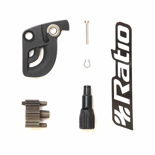

For the record you can upgrade sram mechanical to 12 speed if you would like, the link is here;
