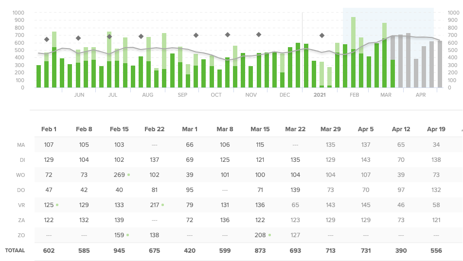

update - I’m in week 9 of SSB HV, so 3 more weeks left after this one.
Some observations
  • the SS sessions are quite manageable - no struggle at all. I seem to be able to hold the power for extended periods of time - on Sunday, I paced a group ride for nearly 3h - IF for the ride was 86% (241W) - 210 TSS. It was hard work, but I never faded.
  • my recovery rate seems to improving - ie I feel pretty good all the time - I did Galena+3 today with a TSS of 139 - it feels as if I did not ride today
  • despite the recent volume build-up (eg last week I trained every day - 873 TSS) and without any real recovery periods, my RHR is pretty steady and has even dropped
  • this week I noticed that my pwr/HR ratio (efficiency) has significantly increased for the sweetspot sessions
  • my Garmin body battery does not deplete as much as it used to, and I am able to get back to 100% during most nights
  • my Garmin shows that my VO2max is improving
  • I have been doing 3x 30 minute strength training sessions a week - mostly focused on functional strength and core work, as well as daily 15-20 minute yoga sessions
  • I do feel flat from a power perspective - as if I don’t really have a punch left to sprint up some hills repeatedly, which I assume is expected, and will come back during Build and Specialty
Question
I’m wondering what to make of the improved efficiency this week for my SS sessions? My HR used to be in the high end of Z3 (Tempo), low end of Z4 (Threshold) for SS sessions, however, this week my HR has been staying mid Z3. Either I’m building up way too much fatigue and not able to recover properly, impacting my heart’s ability to go up, indicating overtraining. But if I were overtraining, I would expect my RHR to be significantly (>10%) elevated as well for days in a row, which is not the case, on the contrary even… Or could I be overtraining without any RHR increase? Or, are these just the desired adaptations following the training regime of the last 9 weeks? How can I tell which one it is?

[update] - I’ve been working with a coach/trainer since April 19. Three months later, I did another ramp test on July 23 and got 307W, up from 284W on April 18. This brings me to ~4.2 W/kg (up from 3.89 W/kg).
However… it looks like my muscles and tendons could not really coop with this significant increase. Now, about 6 weeks later, my left knee is killing me due to an inflamed tendon. I guess I was too stubborn to listen to the signals my body was giving me… from a cardiovascular perspective, my recovery has never been better, however, over the last few weeks my muscles started aching and I was sore after workouts, a first since I’ve started riding the bike. I guess I should have taken a slower approach by only gradually increasing my FTP and workout intensity to get to my new tested FTP… I’ll have to take some rest off the bike now to recover. Hopefully, I won’t lose too much of that fitness I had…
