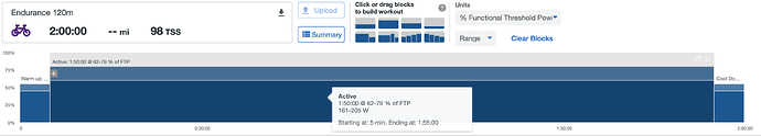

With your 230W, for an endurance ride I’d do 15 minute warmup to get out of town, then 30 minutes around the middle of 60-70% (138-161W for 230ftp) which would be roughly 150W and then ratcheting up to 165-ish for 45 minutes, then 15 minutes around 175W (75%) and then 15 minute cooldown. But I’m a fan of progressing power during endurance work. If feeling fatigue I’d ride a little longer at 150-ish and progress more slowly and skip the last 15 minutes at 75%. But again thats me.
I’m not saying do 5 more watts because the power is “low” in an absolute sense. I’m saying add a bit more power (and 5 watts is my default “baby steps” amount) because the OP said the power felt too low and there was significant negative decoupling on the ride.
Unless we’re saying that significant negative decoupling is a non-issue. :man_shrugging:t2:
just above posted what I would do, I’d push the first 30 minutes to around 65% which would bump it from 130-ish to 150-ish. But again thats what I would do, after having a top-tier coach for 3 years and going thru another top-tier coaches Winter group training program (Tim Cusick’s JoinBaseCamp).
Here is my EASY PEASY 2 hour endurance (based on BaseCamp)
and my more performance oriented 2 hour endurance (adapted from my coach):
Always let the power come to me, and then push power.
The default middle ground is what I posted in words above.
