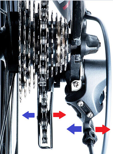

Does this help?
  • Think of the Barrel Adjuster as a “Steering Wheel”:
  • “Steer” the barrel to the RIGHT, adjusts the RD to the RIGHT (red arrows)
  • “Steer” the barrel to the LEFT, adjusts the RD to the LEFT (blue arrows)

It definitely helps, I think I had the direction correct but I was never able to get past the original issue - either can’t get into smallest or biggest cog.
