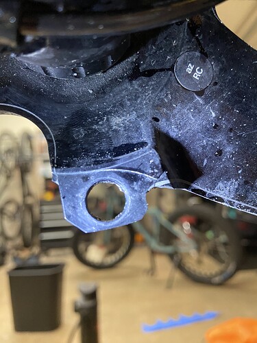

I HIGHLY recommend everyone do this, I posted above some cracks on my crankset - this is what it looks like with the rings removed.

Your photos are great but I can’t actually make out the issue. Would it be possible to describe or circle where the debonding is happening?
I have not had a de-bonding issue “yet” but when Shimano had posted their original inspection video they recommended checking the chainring “ears” for hairline/micro cracks.
I have highlighted in red the cracks my crankset has which shows a crack leading to a bond/press point for the 2-pieces.
Got it now thanks. It looked like a joint point rather than a crack in original photo.
