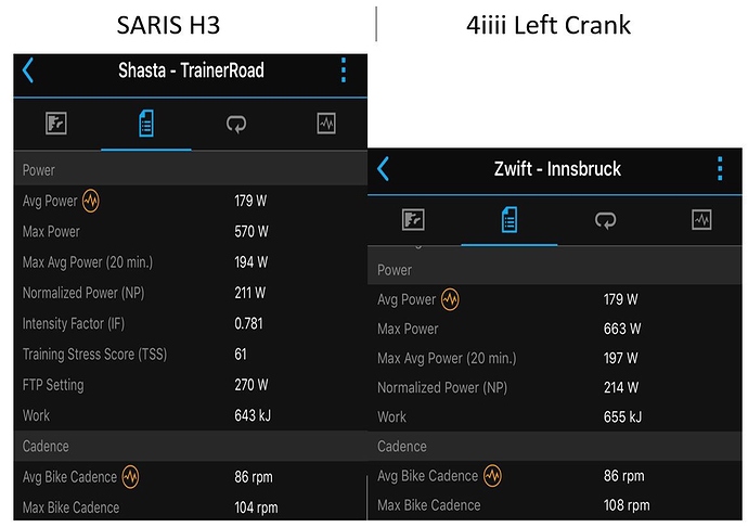

How you collecting and analyzing this data? Are you just looking at a screen and/or bike computer?
I am doing Shasta tonight and use the H3 to record the data via the TR app. I will record the 4iii left crank data on Zwift and will post the comparison.
Disclaimer: I am not concerned with variances as I use powermatch 100% of the time but a good test for others to see. I did calibrate my H3 yesterday after a 45 minute ride (which felt awesome trainer wise) via the Saris app.
Hi again. Just completed Shasta and i really like the H3 and how smooth it feels. I was running TR workout with the Saris H3 and then running zwift in the background with my 4iiii.
To me the power between the two were close enough and I did like how the saris handled erg mode. Below are the two photos to compare. I did not run them through an analyzer. I know before there was a cadence issue but did not see any issues on the TR side and matched what my 4iiii was doing on zwift so that must have been fixed with the firmware they released.
Drop out on 4iiii and H3 was due to me getting off the bike to grab something around the 36th minute. Zwift was bt and TR was ant+. Power and cadence graph are pretty close and NP was 211 for the Saris and 214 for the 4iiii. Max power was also pretty close.
