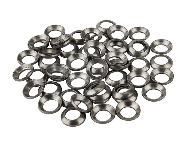

  2. nipple washers, as none of the rims I was looking at the last 10 or 15 years have eyelets. The last rim’s I used which had eyelets were Mavic Open Pro’s, but the latest open pro’s still aren’t wide enough for what I’d like. The nipple washers seem like a great idea to distribute the load over a larger area and reduce the chance of eyelet cracking.
DT only sell nipple washers with a taco shape to them, for specific rims. I’m not using those rims. So I’m wondering about using Stans nipple washers or maybe some Sapin ones.

I generally use Sapim washers on anything carbon. Building a driver out of an old spoke helps with these, you can load the spoke/washer and feed it from underneath which minimises the chance of dropping a washer into the rim by mistake.

Washers: I only use them when required. Adding something that isn’t required to a system like a wheel which is under tension seems ill advised. You could potentially introduce a larger amount of force in the area around the holes than was anticipated by the manufacturer. (After initial lacing I also use a bright flashlight to verify all the washers are setup right before I start tensioning, Just In Case… The DT hoops I’ve used that require washers have all come with washers) Adding washers when not specifically required just seems like adding potential badness down the line. I’ve only had one wheel set have hole damage, and they were over 15 years old. Probably just too old and ridden hard. In that case, I doubt that washers would have made that much of a positive difference. Use at your own risk.
