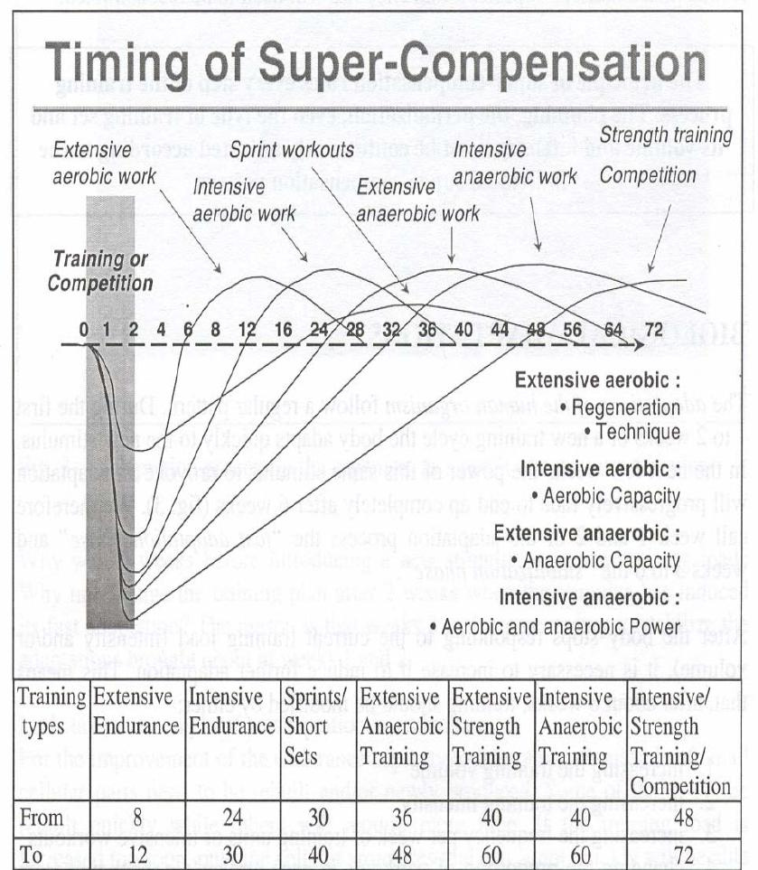

based on this dose-response curve:
Seems like you’re basically picking up adaptation for free by adding even just a short, easy 30 minute ride at the end of the day (assuming you did your main ride in the morning).
might not be a lot, but it’s free, no downside. As long as you keep it easy it won’t even impact your next-day training (negatively, that is). What say?
