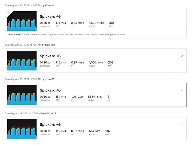

Not apples to apples, but here’s my most recent TR workout, Striped -4.
Not pretty, but not a failed workout. You don’t need a perfect workout graph to get most of the training benefit.
