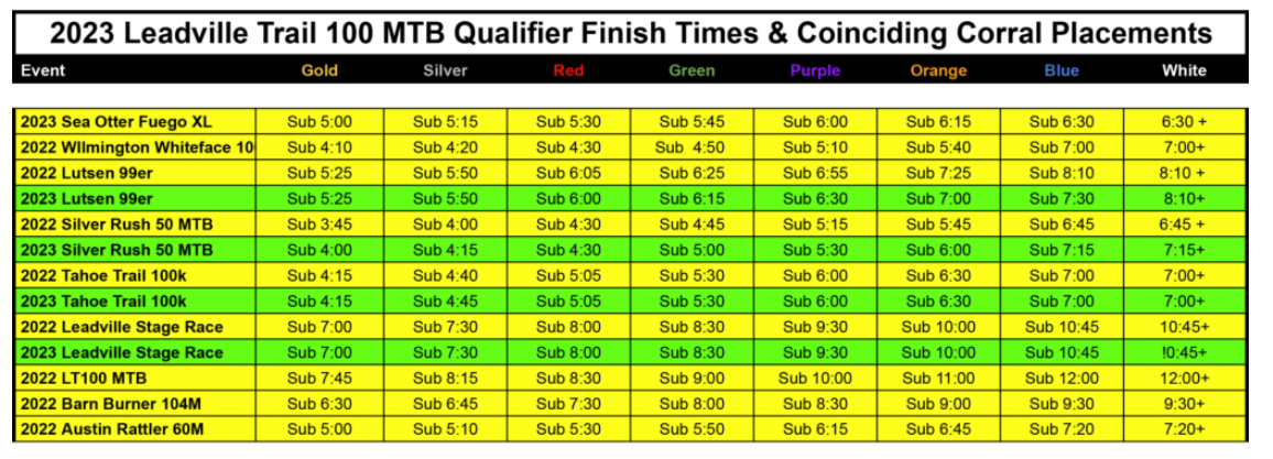

It’s generally the current year or prior year qualifier (if the qualifier happens prior to leadville during the year). See list of qualifier events and corral times below from the lifetime website (all of these can be used for corral placement for 2023 race). Since you can get a leadville spot and defer to a future year to do that race, this allows you to still use that race for corral placement even if it happened over a year prior. There have been some exceptions made the last few years due to the registration screw ups and covid, but I think those are mostly flushed out at this point.
Thanks. Just odd that they’ve announced corrals, but the 2023 Tahoe Trail 100 hasnt happened yet.

I just raced Lutsen as well and my time puts me just a few minutes off from silver, so I am holding out for a slight adjustment, too. I did a quick comparison of placings at Lutsen per corral time between this year and last year. This has me thinking that an adjustment is probably needed for green and lower but gold through red look pretty similar.
I just completed Lutsen99er and narrowly missed the cutoff for the green corral at least based off of the, not yet finalized, 2023 lutsen99er corral times. The course was a little different this year and they anticipated faster times so the estimated times for 2023 cutoffs were faster than the 2022 event by 10 minutes for the green corral. (6:25 versus 6:15)
I compared times from 2022 to 2023 and it turns out they’re almost exactly the same (I’d guess on average only 2 minutes faster for 2023 versus 2022). So I’m now eagerly awaiting the finalized corral times for 2023 and hoping that they’ll be more similar to the 2022 cutoff times which would then give me a green corral time.

They change the corral qualification times for qualifiers if the course itself is substantially modified from previous years, but not usually just due to environmental conditions on an unmodified course. The more common example is what if it’s just really hot on a particular course one year. That’s going to impact times but they’re not always going to change the qualification times.
They certainly might do it, it’s just not a default thing they do in my experience over the past 5 years or so.
Based on what I’ve seen in the past for other qualifiers, they don’t typically adjust (in either direction) unless it’s way out of whack (much more than 10 minutes). That doesn’t mean they won’t do it this year (especially if they were feeling out a course change), but I personally wouldn’t get my hopes up. What makes you think the published 2023 times aren’t final? Is someone at Lifetime saying they are reviewing it based on results?
