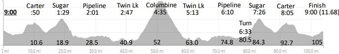

Here’s one with just the time splits -
Thanks for those. I put together some similar splits out of bestbikesplit adjusting for my training elevation of right at 2k feet for the course. I realize it is below the optimal w/kg for sub nine as I’ve seen, but it’s seems at least possible.
