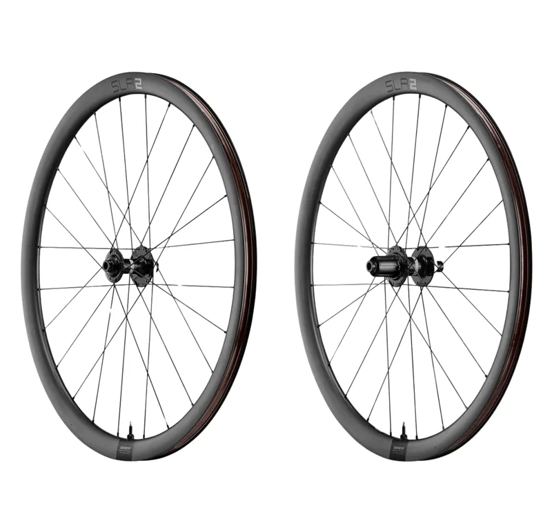

I wouldn’t consider those wheels if the idea is gravel. If I’m not mistaken, they are road only, not as durable as gravel-oriented such as the CXR-2 CXR 2 | Giant Bicycles Canada
I believe the op wants a set of road wheels for his gravel bike
Thanks for the link, decided to get these
Price was good and most wheels from Hunt and Scribe are on back order
