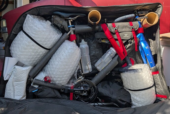

One little trick I did (EVOC soft sided) was grabbed a narrower back foam roller (18") and placed it through the rear triangle such that if the bike was laid sideways under other luggage it would provide some rigidity. Pool noodles and plumbing pipe insulation everywhere else.

This. I have had really good luck traveling many times with my Evoc Pro bag. I use the base that locks in the front and rear. I also use pipe insulation anywhere I can get it to protect the frame.

Pool Noodle isn’t as useful as a foam roller. The roller acts as a spacer, i just use pipe insulation in mine. Also I just suck it up and pay the overweight fee (or upgrade to 1st if the price is a wash on delta) and pack an extra 15 lbs of stuff in my Evoc.

I’ve used an SCICON soft case for around 5 flights now with the only minor issue being my shifters got knocked in on 1 flight (but moved back with no damage). I also pack my clothing in bin bags around the frame and use pipe insulation on all “contact” surfaces that I can.

I have roll of 3/4" velcro that I use to strap things down and to supplement the straps supplied with the bag. I took the rear mech off the mount and strapped it between the chainstays and did the same with the rear brake as it was sticking up a bit higher than I was comfortable with.
